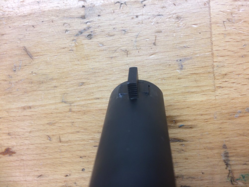

  3. This is for traditional category, I presume? I make my own front sights but it’s very close to the Cylinder & Slide part in Brownell’s 206-000-044. It will likely be tall and you’ll have to file to fit. I also prefer the Harrison Design rear.

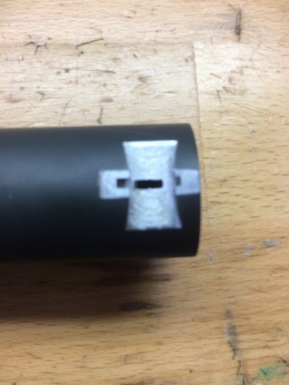

  17. There are three different tenon sizes. And blanks are available.
