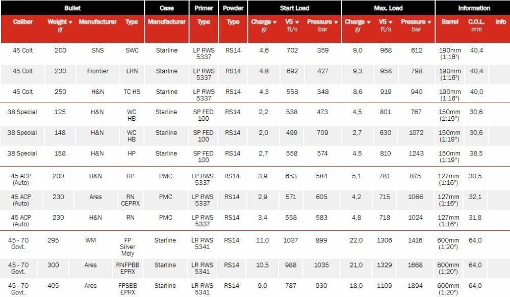

Equanimous Phil Posted June 2, 2023 Posted June 2, 2023 (edited) 5 hours ago, Garrison Joe said: There is no powder closely comparable to Trail Boss, because of it's extremely fluffy consistency. Objection, there's (at least) one. RS14 from Reload Swiss was introduced end of last year. But I don't know if it is already or ever will be internationally available, though the website lists USA and other countries. RS powders are made by Nitrochemie Wimmis. They produced some powders for other brands like Alliant and Hodgdon in the past. So RS14 may come to your market by a different name and brand. With Trail Boss gone, there should be some buyers! I am using 5.2gr of RS14 for my .45 Colt pistol loads with a powder coated 230gr RN bullet. I am happy with it, but load it for pistols only because of it's price tag, it's absurdly expensive! There are only 400 gram (ca. 0.88 lbs) containers available for 92 Swiss Francs, that's about 102 USD. As I don't shoot that much CAS I bite this bullet. Before, I was loading Vihtavuori N32C (Tin Star), but that is like TB no longer produced. RS14 is REACH compliant which is a European regulation. I hope (and assume) it is also compliant with international chemical standards. Something to read about RS14: https://www.reload-swiss.com/en/reload_swiss/produkte/rs20_pistol_powder/rs14_rifle_pistol_powder/index.php https://www.reload-swiss.com/en/reload_swiss/tipps___tricks/tipps_und_tricks_neu_1/einfuehrung_rs14/index.php Here's some loading data (there's a lot more calibers on their web site): Equanimous Phil Edited June 2, 2023 by Equanimous Phil Quote

Garrison Joe Posted June 2, 2023 Posted June 2, 2023 (edited) Thanks for the data on RS14 powder! Well, RS14 has a couple things not going for it. Haven't heard of anyone in USA carrying it, distributing it, etc. "absurdly expensive" - yeah, that is surely what I'd want to shoot action pistol with. One big reason I never used TB. The 300 Blackout shooters may want to pay that and search for that. I understand they were the ones driving the prices on the last supplies of TB out through the roof in the last year. SO many other good choices available to US shooters. good luck, GJ Edited June 2, 2023 by Garrison Joe 1 Quote
Equanimous Phil Posted June 2, 2023 Posted June 2, 2023 I guess those special powders like TB and RS14 are a good choice for casual reloaders like me because they're quite fail-safe. When I am not figuring out a new load I have a reloading session only about every other month, so there's quite a lack of routine. As we have only one active CAS club here in Switzerland I maybe use 1500 pistol rounds a year for the couple of shoots I attend and a few training sessions (no, I will never get really fast...). That equals 2 bottles of RS14 at max per year. For the rifle I load a higher PF and use VV N320. And I still buy factory 9mm which I shoot the most by far (IPSC). Probably the vast majority on such forums are experienced reloaders, shoot large amounts of ammo and maybe are loading for other family members, too. Then you have to think more economically, of course. I wonder what the price tag of RS14 will/would look like in the US, because if you have competitors prices are dictated by the market. 1 Quote
