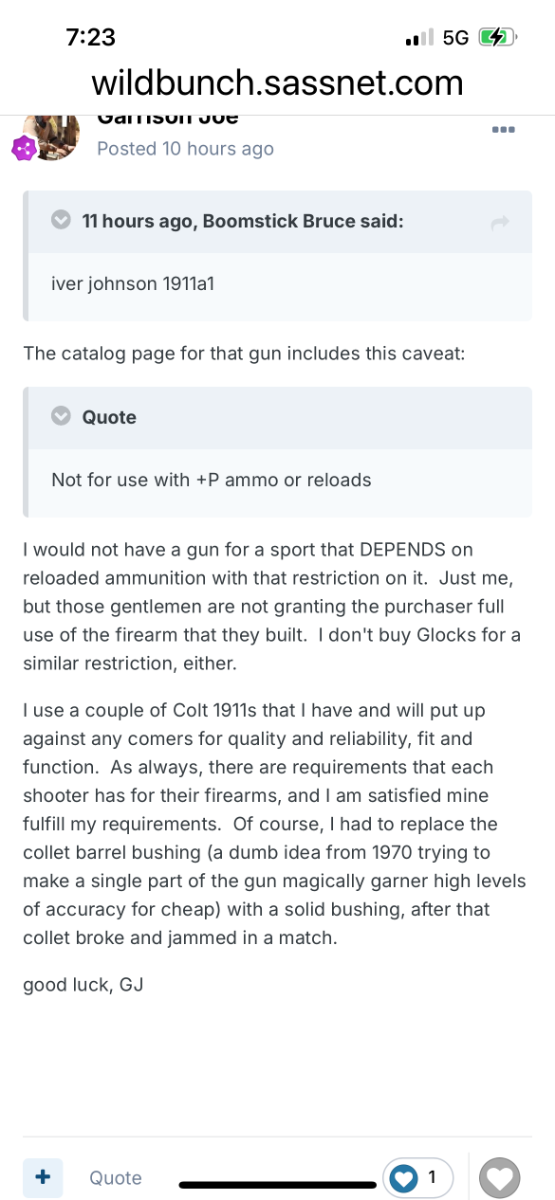

48 minutes ago, Boomstick Bruce said:
iver johnson 1911a1
The catalog page for that gun includes this caveat:
Quote
Not for use with +P ammo or reloads
I would not have a gun for a sport that DEPENDS on reloaded ammunition with that restriction on it.  Just me, but those gentlemen are not granting the purchaser full use of the firearm that they built.  I don't buy Glocks for a similar restriction, either.
I use a couple of Colt 1911s that I have and will put up against any comers for quality and reliability, fit and function.  As always, there are requirements that each shooter has for their firearms, and I am satisfied mine fulfill my requirements.  Of course, I had to replace the collet barrel bushing (a dumb idea from 1970 trying to make a single part of the gun magically garner high levels of accuracy for cheap) with a solid bushing, after that collet broke and jammed in a match.
good luck, GJ

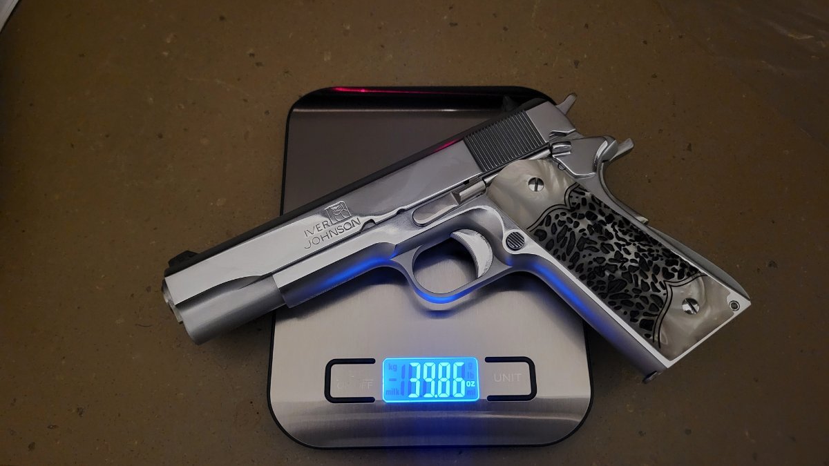

Hey Broomstick,
  I would check the weight on that gun, the website states 42 oz, unloaded.  Not sure if this weight is with an unloaded mag or not.  Traditional unloaded weight is 40 oz, with an unloaded mag inserted, per SHB.

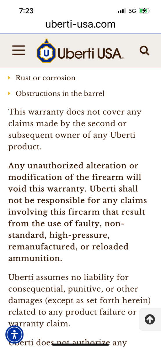

Does that include Uberti ‘73s?
That’s not what you said. You said you wouldn’t have a gun that the manufacturer said you can’t shoot reloads in.
The guns that I know well and can get parts for, I don't worry about manufacturer's warranty.  Need any more clarification?  GJ
Me? No. I never did. You make inflammatory claims about a guy’s gun then get butt hurt when you get called out on it. Do you need clarification?
Every manufacturer today has some caveat in their manuals about reloads, even your pet Colt’s. Have for years. And likely, every one here already knows that. For you to come here and act like his Iver Johnson is inferior because so is unnecessary.

On 7/23/2025 at 9:05 AM, Cardboard Cowboy said:
Hey Broomstick,
I certain that's a misprint, there is no way it weighs that much. that would mean it weighs more than a hi point 45 (35oz) and only slightly less than my .50 caliber L5 desert eagle (48oz)...
Well yes, 1911A1's do really weigh that much, almost.  Steel frames at least.  Standard government issued guns have a spec of 39 oz., empty with mag inserted.  I just weighed four government issued 1911A1's (built in the early to mid 40's) and the average was 39.6 oz, with a government mag inserted.  And these all have the plastic grip's, grips average weight is .5 oz.  So the grips are very light.
On my current traditional gun I really had to put it on a diet to keep it under 40 ounces, with an empty mag inserted.  Frame is Les Baer forged, slide is forged Caspian and then all other parts.  I use thin grip's (plastic) which have been lightened.  My final, crappy, part to get me under the 40 ounce was the use of a Colt plastic MSH.  That saved me almost 1.5 ounce.  Final weight of my gun is 38.3 ounces.  With a standard steel MSH I may hit 39.8 to possible 40 ounce.  Depending on scale used.  Was not worth the risk of going to a large match and get called out for being overweight.
And comparing a steel frame 1911A1 to an aluminum framed DE is apple's to oranges.  Your DE has an aluminum frame.  An aluminum frame can weigh up to 6-10 ounces less than the same steel frame.  And if you did compare it to your DE, claimed wight of 48.6 ounce, 8.6 ounce is a huge difference.  That's the wight of three 45 acp magazines.
So even though you're certain it's a misprint, misprinted on both their website and in the manual for the gun, maybe it does not weigh 42 ounce.  But I bet it weighs very close to 40.  Is it worth the risk of traveling to Land Run or EOT not knowing what your gun weighs?  Drop it on a scale, with an empty mag, and see what it really is.
Holy crap! I ordered a postal scale from Amazon and weighted it... I never would have guessed it weighed this much!! I just ordered an aluminum mainspring housing from hogue. It's not overweight but so close I don't want to take a chance someone's scale is off in case it ever does get weighed.
good luck, GJ
I loved my first Series 70 - Bought it in 1975 for $208 new  - Accurate, would feed anything, eject anything.  The collet never bothered me. Put pachmyers on it and a micro MMC rear sight and used it for 20 years.  One of the few guns that I REALLY regret getting rid of.  I tried to "replace" it by buying another around 2012 that had had the collet replaced with a King.  Good gun but really finicky about what it would feed.   Lost count of the 1911's that I've had but nothing was as good as that first Series 70.
Edited by Joe Lafives 5481L

I'm curious if anyone is aware of a shooter's 1911 being disqualified for overweight at a WB match?
