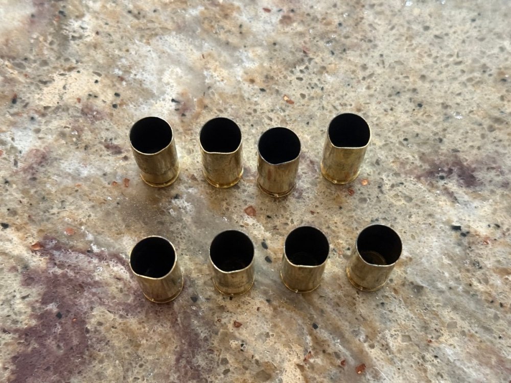

Gun Problem - Extractor Problem - Reloading Problem - Or ???
JJ replied to JJ's topic in Reloading for Wild Bunch
Howdy Again All - Mr Garrison Joe - A great big WoW and Thank you for you response to my question. Your response was amazingly well written and should be a good reference to others. I will be quick to respond back that my knowledge with gunsmithing is dangerous at best and a Dremel has the potential of being a very expensive tool to use while working on guns. Last late winter while shooting the 2024 Wild Bunch Championship Match at Cowtown, the extractor in my Remington failed in the middle of the 42 shot handgun stage. I used my backup Remington for the remainder of the match. The broken extractor was replaced at EoT by a friend of ours from CA. It functioned just fine when used at the EoT WB Match. When I got back to Northern NV, the old extractor in my backup Remington was also replaced. While taking it to the range to test I noticed that the shells were being tossed in about a 25' radius. I then started to do some research on extractor tuning. The article I settled on was this one: http://tonybrong.blogspot.com/2016/08/a-new-extractor.html Earlier this morning I read thorough all of the articles you posted links to and will study them again a number of times. Some great information in those articles for struggling gunwreckers like me. Interestingly enough the author of the article I mentioned, uses the same extractor tuning diagram that Bill Wilson (and the others you referenced) has in his article. It is now easy to see where Tony got his information from. After reading the Tony article, I purchased some micro files and then had to purchase another set of flat micro files along with a head thing that has about three sets of magnifying glasses on it. Off to the races (carefully) I went to filing the extractors on all three on my 1911's according to the diagram. They all toss the brass like they should with zero problems. Guess I am just a slow learner, however am able to learn with proper instruction. I will have to do some research/reading about this 'extractor twisting - Clocking' thing you mentioned. It looks like some intriguing research and learning. You also mention to "look for severe gouge in the extractor cut of the fired cases. A sharp or poorly shaped extractor hook will put a "horizontal gouge" in the angle part of the extractor cut." Yup - there is a definite extractor mark/nick on top of the bottom of the case and on the the side of the cases directly below the case dents. I attempted to get a picture of the extractor attach point, however even my iPhone 16 Pro camera could take a good enough picture to post. Later this week, we/he will have to so some 'careful filing' on the extractor on his gun. Thank you again for your help. You are a great reference person. So - Merry Christmas and a Happy New Year to all. J.J. -

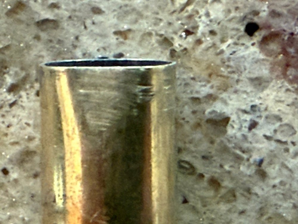

Hi All - Friend of mine just had his 1911 Colt Mark IV worked on. This gun was made in the early 70's and never fired but for a few times. Recently the Main Spring, Recoil Spring and Extractor were replaced. Replacement springs and extractor were Wilson Combat replacements. The extractor was a Wilson Combat 'Bulletproof' stainless extractor. Extractor was tuned using the Weigand 1911 Extractor Adjusting Tool and tested to the 25 - 27 ounce tension recommended on their web site videos with the Lyman Electronic Digital Trigger Pull Gauge. Two magazines of bullets were fired through the gun earlier this afternoon. Bullets used were loaded (mine) with Winchester LPP Primers, 4.5 grains of Bullseye and Bear Creak 200 RNHB Molly Coated Bullets. I have used this load for years on my own guns and have not seen anything like this. The brass was picked up, placed in my pocket and tossed on the counter when I got home. When I looked down at the brass I noticed that most of the shells were 'dented' on the rim and there was a horizontal scratching on the brass. My first thought was that this brass was just stepped on. Then quickly noticed a potential larger problem. Was kinda hoping that someone with a much greater knowledge in what might have caused this 'problem' and an idea how to fix might chime in and let us know. Whatever is going on with is gun needs to be addressed before a couple of thousand rounds are cranked out. Thanks all for looking and perhaps commenting. J.J.
