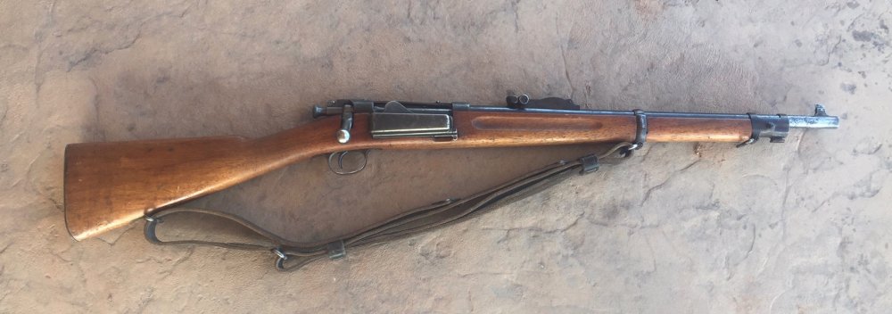

J. Frank Norfleet Posted March 27, 2021 Posted March 27, 2021 You mean one like this? Last night I couldn't sleep so I looked up what a Philippine Constabulary Krag carbine was. Wow, it looked really familiar. I bought this from a widow when I was in college. I just thought is was a weird short Krag. JFN Quote
