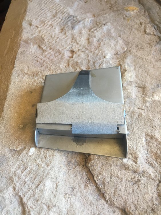

J. Frank Norfleet Posted August 28, 2018 Posted August 28, 2018 The Krag is a great rifle for BAMM. It was used in European competition and the photo below is of a 5 round loading magazine for fast reloads. I have also stood 5 rounds on a table and dropped them in, takes practice. Google for instructions on how to make a loading magazine for the Krag. Quote
