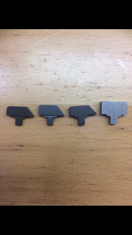

Garrison Joe Posted October 17, 2017 Posted October 17, 2017 I REALLY hope that the big front sight gets WELL locked into the mortise on your slide by the person doing the installation. It is RARE that those big heavy replacement front sights can be held securely by that same tenon design that worked for the little nubby original sight. A dovetail for the big front sight is used by almost all custom 1911 builders because it is much more secure and easily replaced if damaged. Quote
Boggus Deal Posted October 18, 2017 Posted October 18, 2017 There are three different tenon sizes. And blanks are available. Quote
