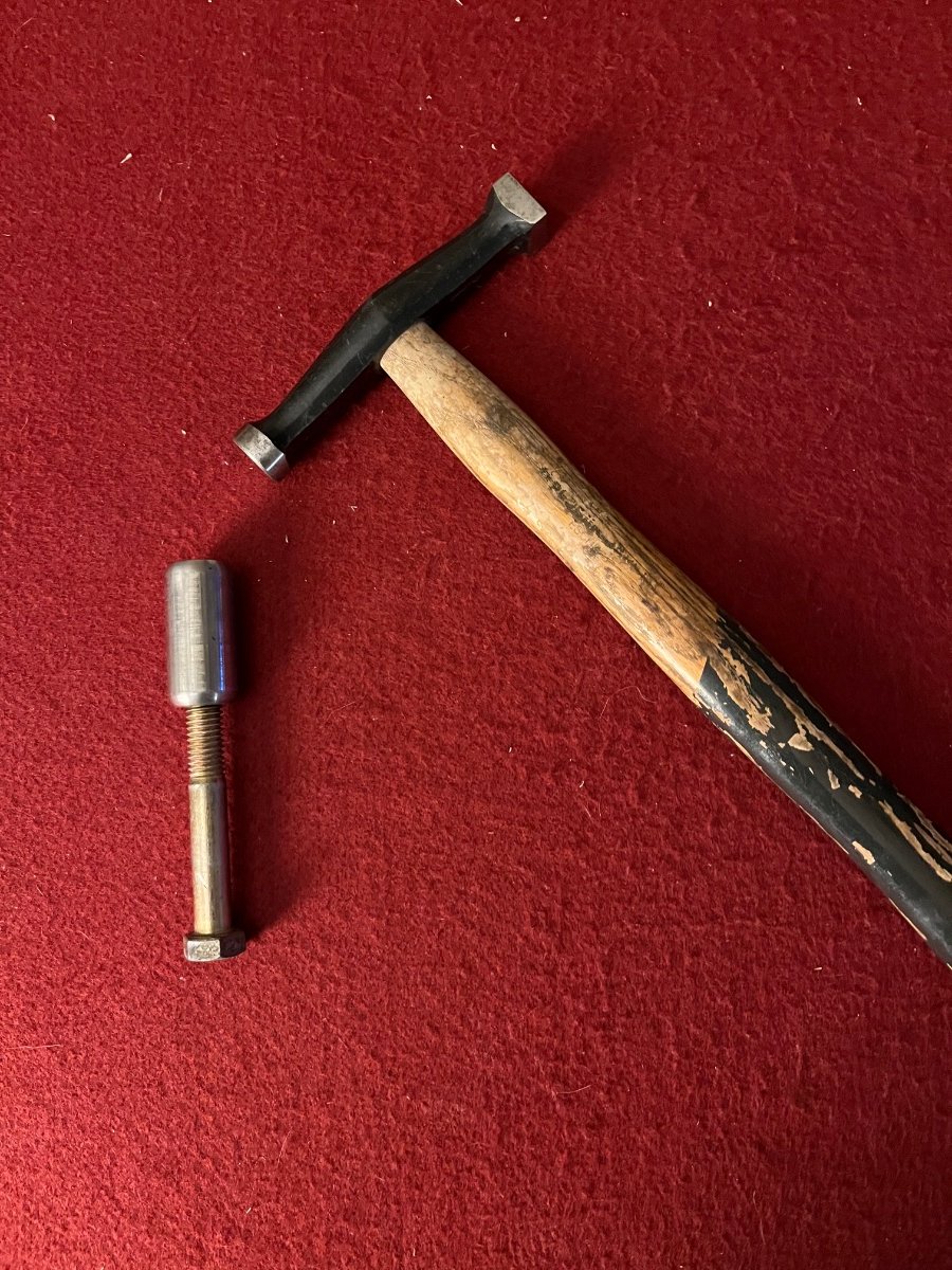

Boggus Deal Posted December 11, 2025 Posted December 11, 2025 Probably a dented tube. I see it often. I have a mandrel and a body hammer that I use to fix that problem. 1 Quote
Bullseye Bracc Posted December 11, 2025 Author Posted December 11, 2025 47 minutes ago, Boggus Deal said: Probably a dented tube. I see it often. I have a mandrel and a body hammer that I use to fix that problem. Yep, just took it apart and found a very small dent and a slight ridge on the inside. looks like a weld repair. Any pictures of those tools? i need something long enough to reach down into that tube to grind out the ridge. Quote

Boggus Deal Posted December 11, 2025 Posted December 11, 2025 11 minutes ago, Bullseye Bracc said: Yep, just took it apart and found a very small dent and a slight ridge on the inside. looks like a weld repair. Any pictures of those tools? i need something long enough to reach down into that tube to grind out the ridge. Both very highly polished and used very gently. The round mandrel is a very snug fit inside the mag tube. 2 Quote

Garrison Joe Posted December 12, 2025 Posted December 12, 2025 (edited) Yep, Brownells also has a tool that is the same design, if you want one pre-built for your own. Mag tube dent raiser Pretty pricey, though. A guy with a lathe could turn one real quick. And this one is pretty reasonable and claims it protects from over-expanding the mag tube. From Defender Tactical. Defender Tactical dent removal tool good luck, GJ Edited December 12, 2025 by Garrison Joe Quote
Boggus Deal Posted December 12, 2025 Posted December 12, 2025 12 hours ago, Garrison Joe said: Yep, Brownells also has a tool that is the same design, if you want one pre-built for your own. Mag tube dent raiser Pretty pricey, though. A guy with a lathe could turn one real quick. And this one is pretty reasonable and claims it protects from over-expanding the mag tube. From Defender Tactical. Defender Tactical dent removal tool good luck, GJ Both of those are for a specific purpose on Remington shotguns and likely wouldn’t work on a tube with a dent 4-6” down the tube. 1 1 Quote
Garrison Joe Posted December 12, 2025 Posted December 12, 2025 The Brownells tool has about 11" handle and the tool body is about 8", so it will reach at least to middle of almost any tube. It's made for most 12 gauge tubes except Mossberg models. One of the review comments on the Brownell's tool says: Quote Had a Winchester Model 12 with a dented mag tube.Used a hammer and the dent remover as a mandrill and the tube smoothed right out.No more stuck follower. Believe Brownells is probably pretty knowledgeable about this one, like they usually are. good luck, GJ Quote
