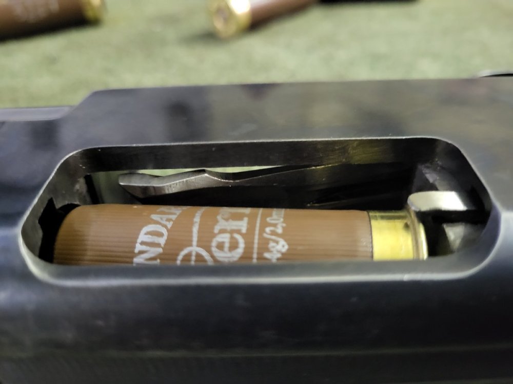

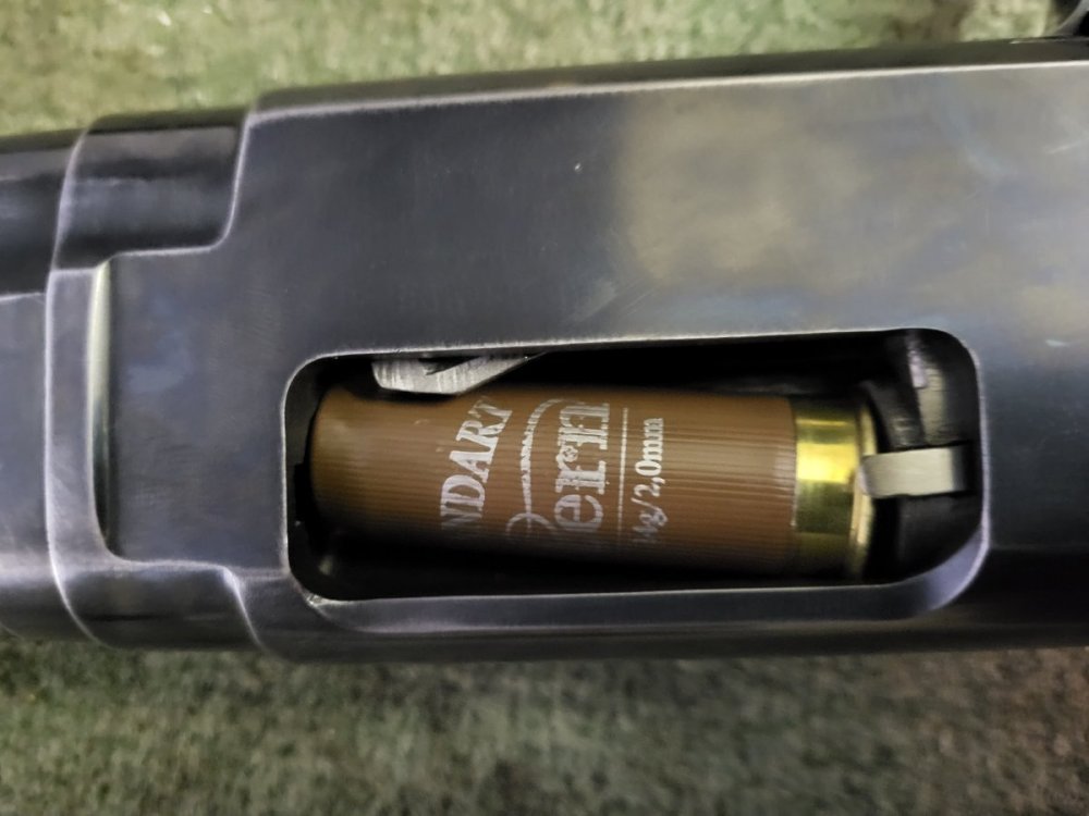

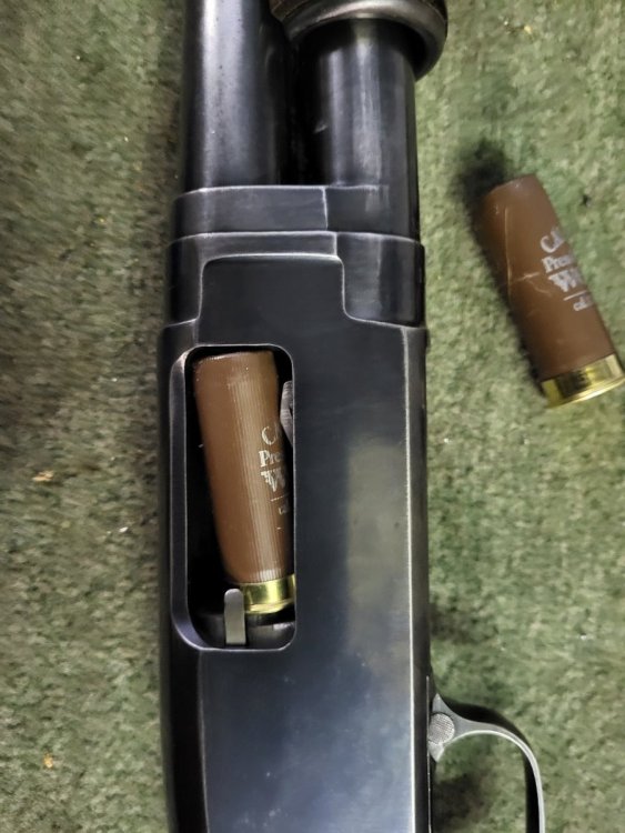

So i come to my problem: i get a Winchester M12 Gauge 12 2 3/4 (produced in 1953)
The most times it works but sometimes there is a loading problem (you have a "felling" in the handling something sucks/plugged?) -> it ´s no matter of slow or fast handling
or hold it horizontly -inclined.
Below i take some pict ´s after a feeling to get a disturbance. So what parts  of the feeding system (without shells there an absolute fine function) are known of
make problems?

I also had problems with a Model 12 like you are describing. After many frustrating hours I finally came across this:
https://jackfirstinc.com/winchester-12-12-ga-carrier-assembly-no-ledge-w-cartridge-guide-112-9212-10?limit=100
Ordered a couple of them. One used ans one old/new stock. The old/new stock would not work in the gun. When cycling the old/new stock locked up the gun tighter than a drum. Apparently it had to be tuned. Placed in the used one ordered and have not had a problem since.
The other solution for you is to hold you gun angled to your left, if you can remember to do that when shooting as fast as you can. This seems to work also, but not as reliable as the carrier with a flag.
Kinda spendy but I believe your problems will be solved.
good luck!!
