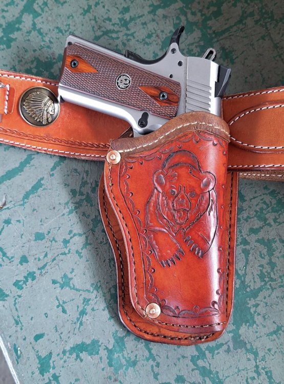

Look what a good friend surprised me with yesterday at our monthly WB match in the carpark whilst Jenorado and I were unpacking our cart. A hand made, lined with tanned kangaroo skin, customised with a tooled bear, 1911 holster for my SR Ruger which up unto yesterday I had been making do using my single action holster. Thank you Rusty for handcrafting this for me, you bowled me over with this kind and generous gift yesterday 🥰

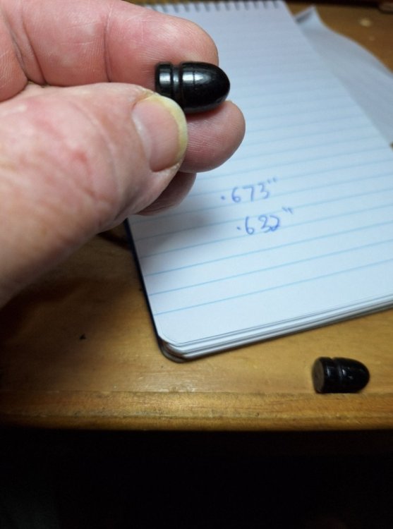

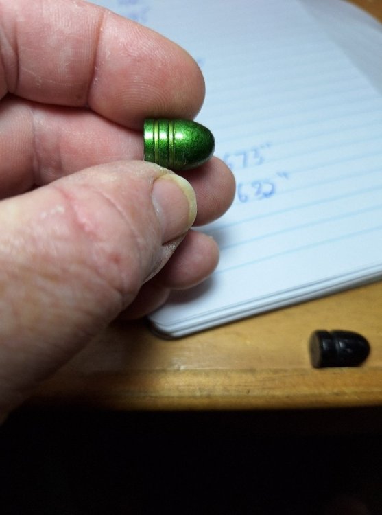

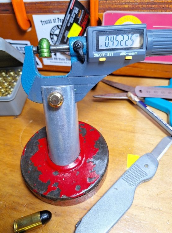

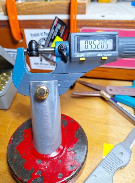

Measured the two pills that I have and also their length so fully understand now how the reloading manuals OAL's are meaningless if they don't tell you the pill. Got the crimp good now. Loaded round are going in easy and dropping straight out of the case gauge and pistol barrel and I can turn them with my fingers in the barrel. Did put some Hornady locking rings on the Dillon dies, made things easier for me. Its all fun.......just hot in the shed in the middle of Summer!!! -

Recommended OAL using 230gn Projectiles and WST, started Googling and jeez there's a whole lot of differing opinions. For the popular and soft shooting WB load of 230gn pill and 3.8 - 4.0 load of WST what's your recommended OAL? 1.260 and loaded rounds ejected on my SR1911 hang up and get caught, 1.250 load and fire OK but Hogdon say 1.200 below. If you load (and this is something I don't understand and would appreciate and explanation) at OAL of 1.200 and your rifling starts at say 1.250 what happens when the pill jumps across that .50"??? I know I'm asking a few questions lately and appreciate the replies all.

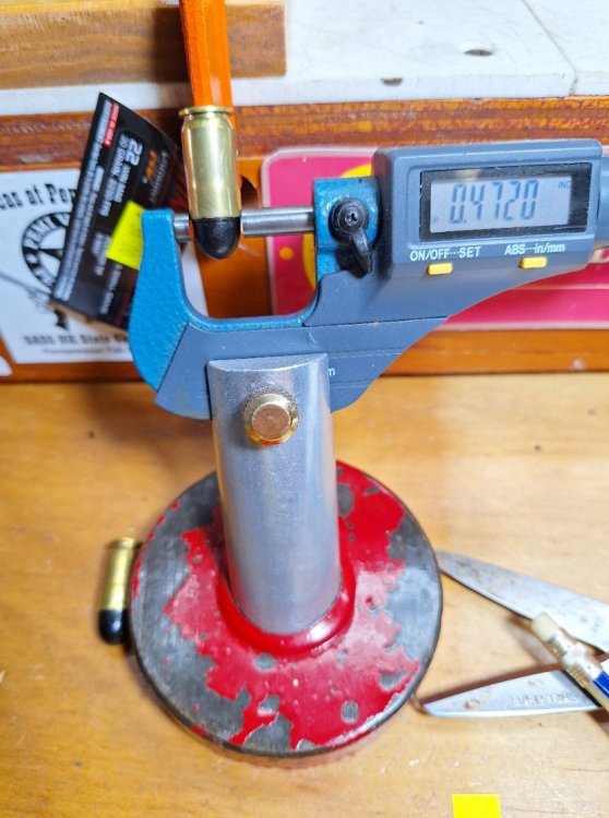

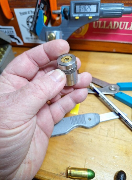

Thanks all appreciate the advice. I've loaded for a lot of calibers over 40+ years and .44-40 and now .45auto have been the two that have made me feel like a total novice. Been so busy with Christmas and its blisteringly hot down here so I haven't been able to spend long stretches in my reloading room. Put the Dillon crimp die back in and found and followed this setup suggestion and I think I have it nailed. Reading heaps....it seems .468 is the crimp to aim for with lead pills? I have noticed that using a kinetic hammer on a dummy round loaded using the Dillon crimp take a LOT more whacking to remove the pill than one loaded using the Lee FCD? -

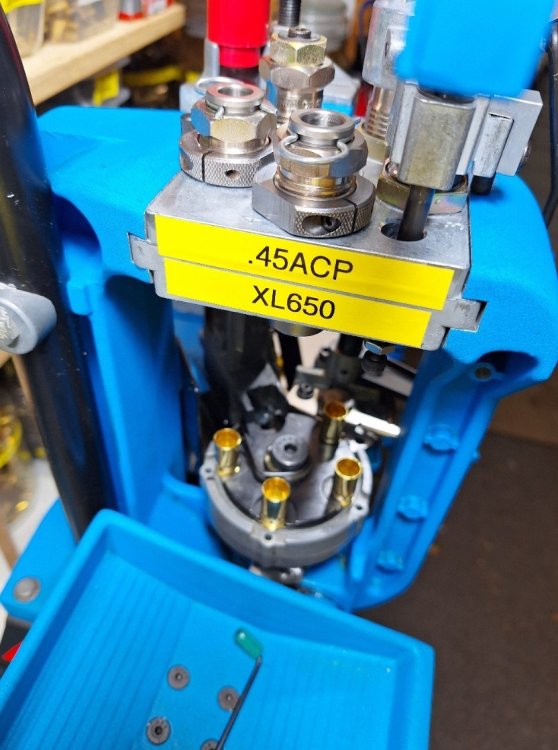

Newish to loading .45acp on my Dillon Xl650. Just installed the conversion kit and dies, not getting the greatest reliability in the final Dillon crimp die as some rounds feel tight in the Dillon case gauge whilst others plop in and fall right out. Replaces the third Dillon crimp die with a Lee Factory crimp die and getting the results that I want, but wondering why the Dillon crimp die isn't working as well (rather use the Dillon die) is there something that I haven't done right setting it up? Any hints? Should the Dillon crimp die be working so that every completed round plunks in and slides out of the Dillon case gauge with ease? Thanks in advance.
