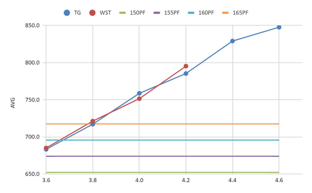

BradyT88 Posted May 8, 2024 Author Posted May 8, 2024 (edited) I got my hands on some WST and thought this was interesting. These are 5 shot averages at the same powder charges with 230gr bullets. I would have to shoot them again to feel the perceived recoil. When shooting them I went from 3.6gr of TG to 4.2gr of WST so of course the felt recoil went up with the big power factor step up. Looking at the cases after shooting the WST ones are much cleaner on the inside than TG. 3.6 3.8 4.0 4.2 4.4 4.6 TG 683.2 717.0 758.6 785.3 829.0 847.6 WST 685.0 721.2 751.4 795.2 Edited May 9, 2024 by BradyT88 4 1 Quote
