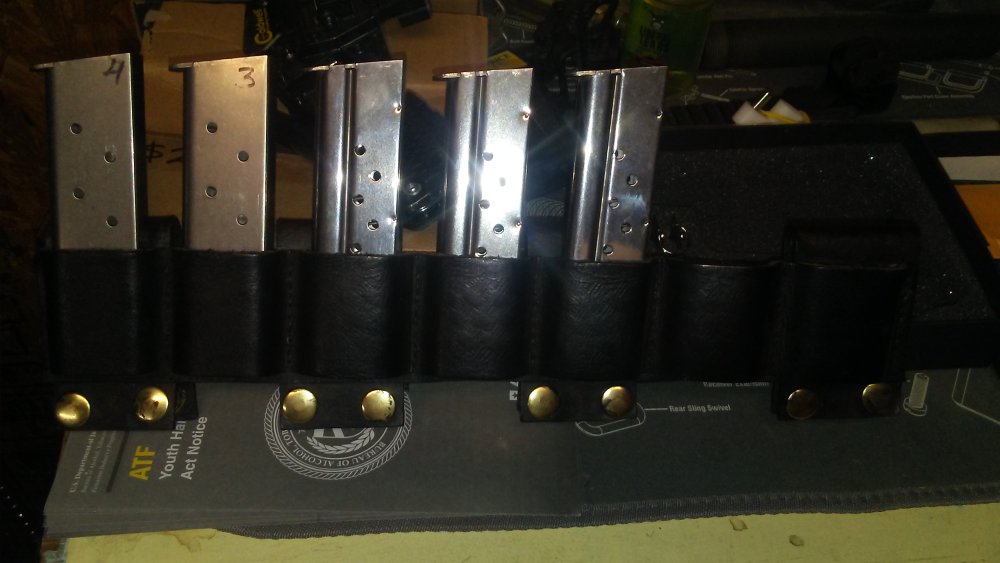

  6. It was originally a belt, all sewn to the belt. Belt took a crap so I cut them off and added the snap feature to fit over new belt but I didn't think they would be considered legal by definition of the rules. I made new mag pouches but if this could be reviewed and ok'd that would be great.
  7. This is a 7 mag holder that snaps over gunbelt, is it legal, or do they have to be split in pairs.
